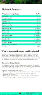

I got a pack of the Bardee slow release pellets and fast release powdered black soldier fly frass and it looks nice, I thought it would be really dry but it's got a bit of moisture in it, it looks like it would break down quite quickly. I downloaded the npk and what's in it and it seems OK..next run..

Just been reading through and you may have been onto somthing with that Mick. Since this thread I have discovered canna bio has the same NPK in veg and flower and is high in K
Is calcium normally that high with other nutrient brands? This one says 8.6,%, which is 2.5 times higher than its Nitrogen volume. Seems high?
Not sure I never really paid much attention until recently
8.6% calcium is a good number. It should be in way higher amounts than nitrogen in soil anyway so as a general all purpose, this is a good ratio.
Ok, thanks. Do you know why it's not considered to be a macro nutrient like NPK? Given its the highest value, I wonder why it's grouped as a micro nutrient? Assuming a plant uptakes roughly 2.5 times the amount of calcium to nitrogen, if we're supplying it for plants to use via the medium in that high ratio. Is it just a cannabis specific high calcium need, or do most " general purpose" fertilisers also include much higher calcium to nitrogen ratios?
I've always wondered the same as I've got a few organic slow release products here that are 3:1:3 but roughly 9% calcium and the other is 4:2:2 with 12% calcium. Anither here has 2.5% nitrogen, 9% Ca and 8% S as well.
I've noticed this mainly in slow release products, not so much immediate nutrients..
By definition it should be a macro nutrient, surely. I mean why supply the high ratio of calcium into medium, unless plant uptakes it. I've never paid attention to ratios below NPK, as I "mistakenly" understood that macro nutrients would be the most important. Not that it changes anything I'll use, as I always buy the cheapest base nute brand I can get at the time. As my plants don't notice any difference between expensive and cheap nutes.

Plants need a lot of calcium to form cell walls, cell membranes, help uptake of other nutrients... Honestly not sure why it's called a secondary macro.

This is generally the ratio you will see in tissue as well as soil.
