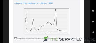

Looks the goods mate, spectrum looks in the zone as well. Is it going to be a top light fixture or are you supplementing sides etc?
Just a top light fixture, mainly just for flowering out seeded plants and autos. Figured that the 4000k with the added reds would be pretty ideal for flowering.

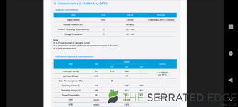

They also have them in 5000k I am pretty sure, unlike most of the Samsung strips these ones are rated between 42v-44v, prior versions being 48v.
Lucky for me I've got some meanwell 42v drivers which were running bridgelux eb gen2 3500k strips (39v I think they were rated for) which are perfect for driving these new Samsung strips.
I'll use my mars TSL2000 for keeping mothers as it has a good spike of blue to keep them short. too many times I've had great plants die on me when attempting to reveg. so I'm just going to have to clone everything from now on.
Here's the 5000k version

White line represents what a cannabis plant can use. It’s important to cover that white line as much as possible on the right hand side and have a decent spike of blue to produce optimum flower
