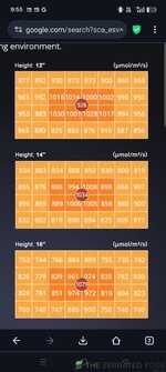

In a 2ft x 4ft I think a Quantum board style light will be most suitable. There’s plenty out there to choose from depending on what you want to spend. Something in the wattage range of 240w - 350w I think would be good for the job👍
@Indy the viparspectra xs3000 pro has probably the best par spread for a 2x4 footprint at a decent price.
Spectrum is odd though with a spike around 590-600nm over the usual 630-660nm spike. Has a standard 3000/5000/660 layout though so I don't know whether to trust their spectrum plot.

Nice find, mate. The XS3000 definitely ticks all the boxes. (y)
I'll look into further. IIRC, there was some speculation about their products/specs a few years back when they were kicking off. Hopefully they've got it together better in more recent times.
