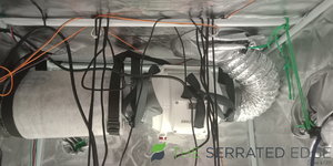

Is it a proper exhaust fan, or just a blade fan pushing air out? Heat and humidity both rise, where is your hygrometer located? Can you share a photo of your exhaust fan set up in the tent and another photo of your extraction ducting ( outside the tent)? How /where have you measured the the of 50% outside the tent?

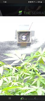

is that a computer fan?

Hows your carbon filter setup, if it's a 30w fan pushing it I don't believe that would be powerful enough

Forgive the messy wires, I've been moving stuff around inside the last two days and didn't want to zip tie it all up neatly till i was done figuring out what works and what doesn't.
I closed off the back flap earlier and all of the sides were sucked in tight.. like stupidly sucked in where it was squashing the plants from inside.

here is the humidity / pressure / temp sensor. it level with the top of the canopy.
