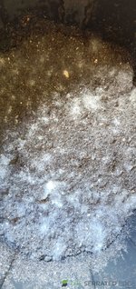

No problem from " my point of view " in asking questions , i can't always answer them but don't mind reading them
first off might not necessarily be a fungus could be a bacteria , see one kind below
indigenous organisms aka organisms from your yard are definitely the go , they are acclimated to your environment & they already speak each others language , better than what is produced in a lab , packaged & sold over the counter
of cause it helps if you take care of the yard / soil your collecting from
no probs adding some but like anything no need to over do it , more of a good thing is not always a good thing :D
is streptomyces a bacteria or fungi?
Streptomycetes are the most important source of antibiotics for medical, veterinary and agricultural use. They belong to a class of bacteria of considerable interest to human welfare that are known as actinomycetes.
Can bacteria form mycelium?
The type species of the genus is Streptomyces albus. Streptomyces thus show differentiation, which is less well known in bacteria. It produces two types of mycelia: spore-bearing structure and spores.
I guess the next question is how much do we need to worry about bacteria being an issue? There's bacteria everywhere, and if it's in my grass clippings which will be 5-10m from my pot, they'll end up in the pot anyways (maybe?).
No you've got me going to google bacterial mycelium Tonight and the I'll effects of innoculayed plant media.
Well said...I'm just going off intuition but in reality I don't even know if the large colonies that form in my cooks are even beneficial. I just noticed that Ill have a pretty cold mix and I'll add some garden soil and within a day or so it's hot and I have this.
For all I know it might not be beneficial, but I seem to be going alright lol. My smooth brain just goes too "mmmm, heat and life, must be good".

in my way of thinking it's not the bacterial organisms that could be a problem , it's the grass clippings that could over do the nitrogen in the mix , too much nitrogen can cause all sorts of problems , from toxicity to making a otherwise healthy looking deep green colored plant more susceptible to pests like aphid

the reason i said to beil it might not be fungal is because it's on a grass pile , in general the cut grass would mostly feed bacteria anything high in lignin would feed fungi , you'd expect to find lignin in straw , like barley straw
just need to say this when talking about straw because some things are called straw when they should be called Hay imo
as a rule of thumb straw has no nutrients in it & is used as bedding for animals where as hay is used as food for animals , the difference is hay is cut before the plant has produced it's seed , straw on the other hand is what's left over after the plant has produced it's seed & has been harvested , barley for instance will grow , suck up all the nutrients it needs then the plant uses those stored nutrients to produce it's fruit , in this case seed , once this is done there is pretty much no nutrients left in the plant , it's why it's used as bedding & not food for animals , when making compost it's your carbon source

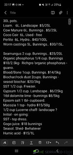

For those playing along at home.
I 'think' this is what I've set upon, I reckon I've taken notes from the input from this thread... But possibly can't see the wood for the trees.
As usual, any input welcome... I'm starting to get everything together now to cook before spring..
So as for my plan... Start seedlings (inside on windowsill, I won't be getting lights for germination) in cups with minimal nutrient medium (with 1" slots so the roots just grow out of them), these will be placed into the mix....... Now these roots will already be like 4" deep coming out the cups... So they probably shouldn't go straight into the 'super' soil? Seems like a lot of wasted space if it needs packing with 'not as rich medium' before they hit the good soil? (Input needed).
Hoping that the medium lasts for the veg stage (out door grow) and will add additional PK come flowering....
No idea if the mix will last through flowing and won't need supplementary PK, but thinking of adding it anyways... I guess I'll figure that out in February (?) 🤷🏻‍♂️
Like most first growers... Just going to wing it, see what happens and probably annoy the fuck out of you guys... But I'm hoping that my initial planning means I won't shit a brick until flowering at least.
Plan to top and LST at 6 nodes, and LST the shit out of everything until she can't go no more.
Much of this may change as I learn more... And happy to adjust.. got a few months lol.
This was before my local soil thoughts, so may amend that.
