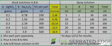

Found this on another site so not taking credit but it's what I'm going by to save as much of the silver nitrate since it goes bad in a few months apparently. I have 2 tanned 100ml dropper bottles for the stock solutions and a tanned 100ml spray bottle all are covered with al foil in fridge. Hope this is helpful
