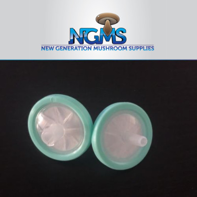

Notice others have basically the same setup with the syringe filters after doing some research.
A list of parts for anyone interested.
And some 3-4mm vinyl tubing, cut to about a cm to push onto the ends of the syringe filters, so they can be jammed into the lid grommet for a tight seal.
Use an 18 gauge needle for inoculating, and for collecting use a 16 to 14 gauge needle that's big enough to slurp up the mycelium.
