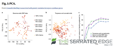

Principal component analysis (PCA) of the genomic data showed no clear clustering according to sample labels (Fig. 1a). Even though PC1 and PC2 were significantly correlated with the Sativa–Indica scale, the variance explained by the primary PCs was low (PC1: R2 = 0.12, P = 2.1 × 10−5; PC2: R2 = 0.12, P = 1.8 × 10−5). Furthermore, the overall genetic structure (captured by including the first ten PCs of the genomic data in a linear model) explained only 37% of the variance in labelling (Fig. 1c). Sativa–Indica labels thus do not accurately reflect genetic relatedness, which is consistent with previous work17,18. In addition, we determined that pairs of samples with identical cultivar names (for example, OG Kush) were often as genetically and chemically distant from each other as pairs of samples with different names (Extended Data Fig. 2). This is consistent with previous studies indicating that cultivar names were not reliable indicators of a sample’s genetic or chemical identity17,19,20,21.
a, Genome-wide SNP data. b, Terpenes and cannabinoids. Each dot represents a Cannabis sample and is coloured by the labelling scale ranging from 100% Sativa to 100% Indica. c, The percent variance explained by PCs from the genome-wide SNP data (blue), from the terpene and cannabinoid data (green) and from both the genetic and chemical data (purple). The y axis shows the percent variance explained as PCs are added to linear models where the Sativa–Indica labelling scale is the dependent variable.

Similar to the PCA of the genome-wide SNP data, the PCA of the terpene and cannabinoid profiles provided poor separation of samples according to their Sativa–Indica labels (Fig. 1b). Nevertheless, we observed significant correlations between the first two PCs and the Sativa–Indica scale (PC1: R2 = 0.049, P = 7.5 × 10−5; PC2: R2 = 0.24, P = 3.7 × 10−19). Including the first ten PCs from the terpene and cannabinoid profiles in a linear model accounted for only 41% of the variance in labelling (Fig. 1c). The pairwise genetic and chemical relatedness matrices were correlated (Mantel r = 0.21, P = 1 × 10−3, Extended Data Fig. 3), and a linear model including the first ten PCs from both the genomic and chemical profiles captured only 41% (Fig. 1c; P = 3.1 × 10−10) of the variance in labelling. Since the overall patterns of genetic and chemical relatedness could not fully account for the labels applied to Cannabis samples, we aimed to determine which individual chemicals were the strongest predictors of Sativa–Indica labelling.
