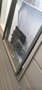

I then put in place of the flyscreen a sheet of perspex with a shutter fan mounted in it to pull the air out.

So this is a shutter fan and if 16995829651427925916987051272894.jpg you look closely you'll see the end of the exhaust ducting. It runs in tandem with the exhaust to help expel the air. The idea is to try keep the ducting out of view. It looks red hot with shiny silver ducting taped to the window and bit messy looking too. But that's just me being anal retentive.
