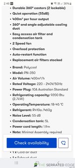

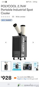

Was looking for a way to inject cool air into my grow room.
came across these bangers.
Anyone ran one of these units into their tent or growroom?

Few good ones there. Cheers Sedge.
Definitely like the idea of having seperate flexible ducts for cool and hot air.
Will allow me to run the cold duct straight into a spare capped off port to my sealed room, and exhaust hot air out into garage.
I was thinking about modifying a normal portable AC to do the same thing as the polyair.
I want to avoid having a unit in the room but not many options unless i go for box or splitty.
