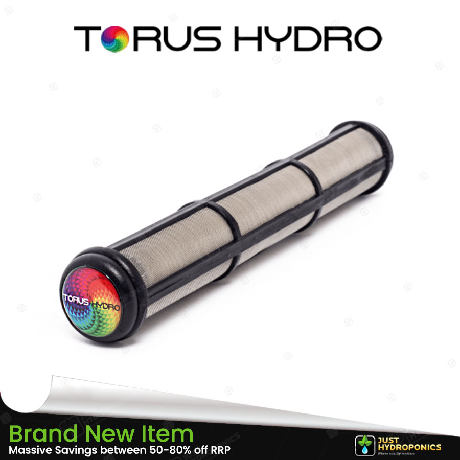

If im running hydro not a run to waste system I like to dump and refresh weekly because I'm a believer that plants will use more of some elements than others and adding more nutes to the res to maintain an EC could lead to toxicity of the elements that are slow to uptake and I also hate aiming for an EC because I always fuck it up.but as for PH there are a few nutes out there that once there set to a ph they hold it Canna Aqua being one. There is also devices that use cation exchange polymers to buffer PH I've been eyeballing the Torus for a while it needs to be charged with a solution before each run but now certain nutrients buffer themselves I don't think I will bother
