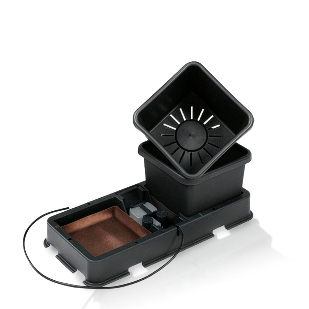

I've been stuck not being able to grow with all my gear since having to up and move earlier last year. For the foreseeable future, I'm going to have to navigate living in smaller places with others which means I need to change my approach. I'm itching to have a play and so I'm considering building a stealth grow cabinet.
I was inspired looking at the cannabonsai guy and thinking that even being able to do small harvests every so often would tickle my need for the hobby as well as provide a little supplement to my medical script. However, I don't want to faff about with bonsai specific training techniques - I just wanna grow a small plant.
On the basis of 30-40w/sq ft, I'm thinking of using the following and building around it:
A single 8.5L pot variant of this: https://hyalite.com.au/products/nutrifield-autofeed-by-autopot-1-pot-extension-kit-boxed
And a 65W full spectrum LED panel https://www.aliexpress.com/item/1005005778251758.html
As for the main cabinet - that I still need to work out. I don't have access to my tools to do a complete from scratch fab, so will look to re-purpose something. However, I want it to be relatively light so it can be moved down the track - ie, I don't want to use an existing piece of furniture made out of timber which is too heavy.
Ideally I'd probably make an insulated box covered in 3mm MDF and some veneer, but will have to go for something somewhat off the shelf. Internal area is to be roughly 500x500 - unsure of height just yet, but will want to keep it tight.
As for ventilation - that I'm thinking of wiring up some PC style fans etc. Will need to think about filtering - seen various DIY takes on carbon filters, but don't really want to muck about with it, so may opt to use a cheapish 4" filter or something.
The only fly in the ointment at this stage is if I have enough time to build and crop before I go travelling for a bit. Still would be some fun to work on in the meantime and be ready for when I get back.
