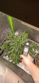

I'm not sure how the spectrum changes when dimmed, but I borrow a mates apogee to figure out how to match it to the lights I have and convert lux to ppfd.
The techplex board matches at lux multiplied by 0.0158 and the kingbrite boards are around 0.0143.
For example the techplex board reads 893umol/s In the middle with the apogee and 56200 with my lux Meter so I stick with the 0.016 formula.
I know at full pelt it puts out close to 1300umol/s in the hotspot at 16" (around 85k lux) in a 3x1.6.

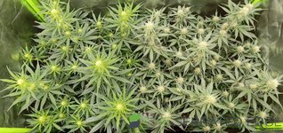

These autos were done at 120w in a 3x1.6, and the one underneath were under 150w in an 80x80. Thats 24 and 21w/ft2.
