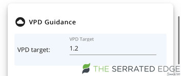

As long as I’m hitting the VPD target I should be right yeah? My tent is normally at 27° 62% humidity which gives me 1.2 VPD
It will work, but if you set your temp/RH higher, the veg growth rate will explode in comparison Try it for a week and see how much faster they grow. Reduce it down again about 2 weeks after flip to 12/12.

Going into flowering stage shortly, should my VPD target be higher than veg stage.
Like 1.4 ?
