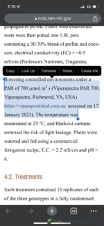

Found out why
Edit: I will throw my opinion here and say this is the kind of research I’m glad to see but from legalisation. Challenging the pre conceived notions established, but maybe not perfected, by hobbiests over the last few decades.
