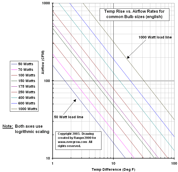

the best vent thread on the web is here(math too) https://www.icmag.com/ic/showthread.php?t=112862
Cheers, man. Good to finally see a formula. Been winging it for years, and making adjustments to suit when required. I'll have a thorough read later, but after a quick skim over the first post it would appear i've in the ballpark for most parts.
