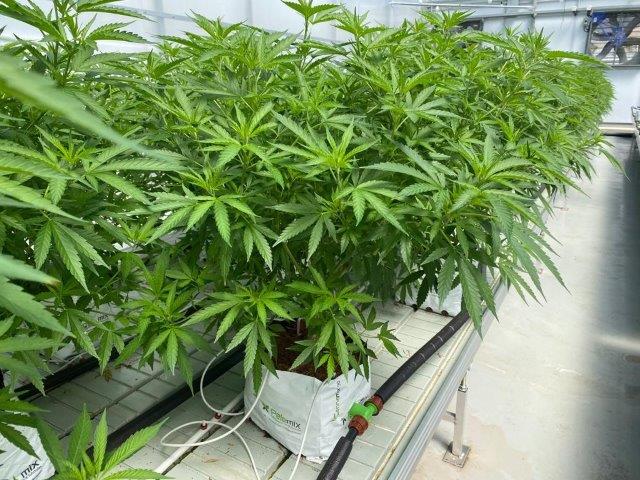

The science of medical cannabis nutrition - Israel Agricultural Technology & innovations Hub
compare to conventional horticulture, commercial crop cultivation of medical cannabis is a new farming niche. while commercial and academic researches regarding optimal growth condition and nutrition for cannabis are still limited, most of the known growing practice is based on growers’...

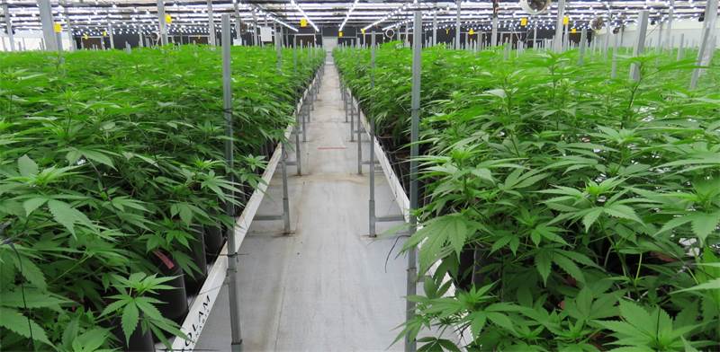

Nutrition for Medical Cannabis Optimal Growth - Israel Agricultural Technology & innovations Hub
cannabis is an annual plant, dioecious, from the cannabaceae family, belonging to the c3 class. it originated from the himalayas and southern asia, as there is evidence throughout history of medical uses of the plant more than 5,000 years ago in china and ancient egypt.the plant’s fibers, seeds...

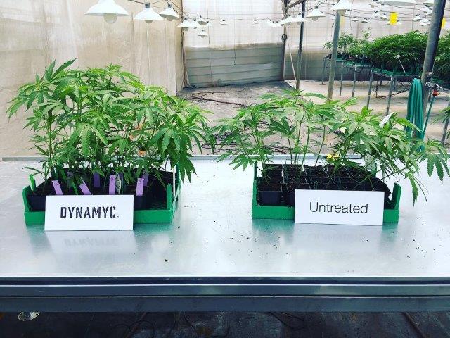

The Benefits of Incorporating Mycorrhizal Fungi in Cannabis Cultivation - Israel Agricultural Technology & innovations Hub
dynamyc™ is a groundbreaking mycorrhizal inoculant developed by groundwork bioag, specifically formulated for cannabis growers. it acts as a biofertilizer by absorbing mineral nutrients from the soil and translocating them into the plant’s roots. dynamyc™ is highly concentrated with unique and...
