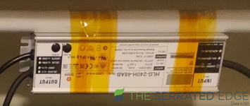

This is a bit dodgy.
The heat from the driver will cause the plasticisers in the tape to be released quicker, making the tape brittle and easier to crack. In the short term it may stretch from the heat.
You may turn up one day to find the driver on top of your tent; a good thing you have a lid on that coolant bucket. :LOL:
j
It pains me to say it , but yeah get rid of that tape , try hanging it
Secretchief
1502
Yea the res and mounting will change, some sort of tub on top incase of leaks etc.
In regards to the tape, it is kapton tape and good for a few hundred C so I wouldn't worry to much about that

Even so I'd still remove the tape ,transformer needs to stay cool the tape will keep it warmer than needs to be
Yea the hanging rail actually sucks a surprising amount of heat but I will find something more elegant. Alot of this was slapped together from what I have on hand so definitely a few improvements to be made.
It comes with a solution built into the design - use washers to protect the slots.
I don't know what the walls are made of but you could try mounting that to one of the walls.... and perhaps add in some spacers to allow air-flow in-between; may not need spacers if the walls transfer heat quickly.
j
They run up to 95c so I will find something eventually, the housing It is only at 40c so no rush and no real need to change.
