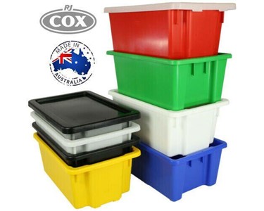

Just to add to what Indy said, make sure the container you use to drain into has some type of lid because you don't want a large container of water with an open top sitting right next to the dehumidifier it kind of ruins the whole point of having the dehumidifier in the first place, does that make sense?
Bloody good point, mate. Spot on. (y)
I put my dehumidifier on a milk crate that drains into a 35L Nylex tub with a lid. Drilled a 50mm hole in a corner of the lid for the hose.
