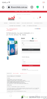

Anyone used Peter's excel?
I've noticed Peter's excel is going for $7-$8 at a few orchid shops. Looks like a good go for Coco and soft water considering both come loaded with 7% calcium and 3% magnesium alongside trace elements.

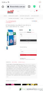

The grow seems alright at 15:5:15 as I already use 3:1:3 with 9% Ca and 3% Mg currently. They also have a 13-5-20 with added Ca,Mg and TE called "finisher" which looks good for flower.
I'll be switching back to Coco next run and will be giving these a try. Anyone used before? I like simple one part feeds so this might be the go.
We just had filters attached to all our taps here recently so I'll probs give it a go.
